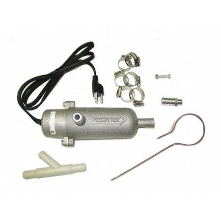

Guest Ray Davis Posted December 31, 2021 Posted December 31, 2021 (edited) Tankless really inhibits your ability to have hot water in cold weather, so you may have to go back to an old reliable tank type. An inventive person might figure a way to have both. In any case, in cold weather you'll need to either find a way to store hot water or pre warm your freshwater tank. Then use your water pump to supply prewarmed water to the tankless. I think some coaches come with warming pads that are to keep tanks from freezing. Something like that might help to prewarm the water before it enters the tankless. Here is a heater pump combined that should heat your water, it would need a thermostat though. https://www.zoro.com/kats-circulating-tank-heater-1000w-120v-13100/i/G8730611/?gclid=e8d6fcbcca63179e42e39d72d231144d&gclsrc=3p.ds&msclkid=e8d6fcbcca63179e42e39d72d231144d&utm_source=bing&utm_medium=cpc&utm_campaign=PLA_US_Bing_Smart Shopping&utm_term=4586131722361390&utm_content=All Products#specifications Edited December 31, 2021 by Ray Davis
